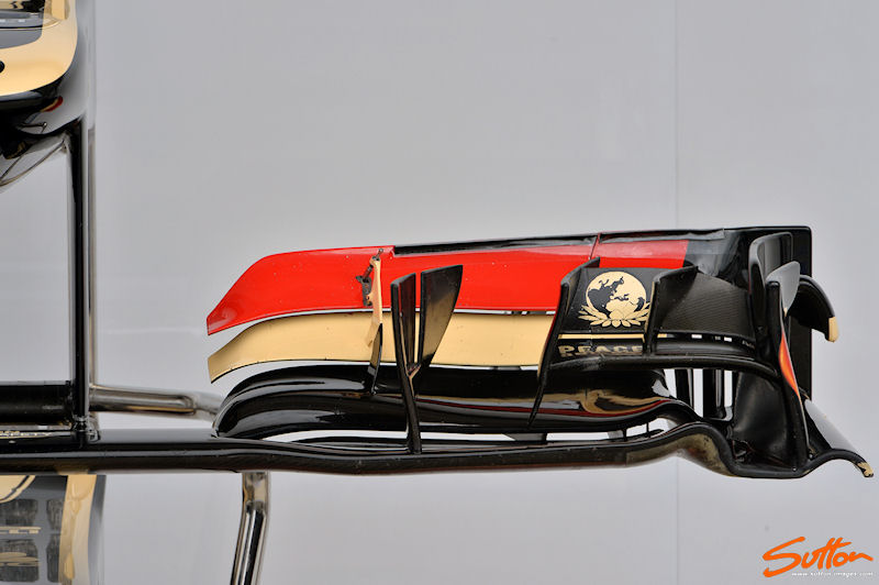

Lotus E21 - Front Wing detail

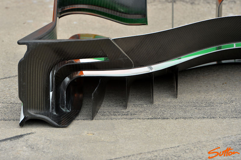

Force India VJM06 - Front Wing from behind, this great shot shows exactly what's going on behind the Front Wing Flaps. The lower strakes align with the strakes added to the front of the wings flaps over the last few races and are used to guide the airflow ahead of the front tyre. The rotation of the tyre behind the Front Wing also creates a pressure build up with errant airflow trying it's best to destroy any airflow regime. The strakes aid in countering this and turn the airflow on the desired trajectory.

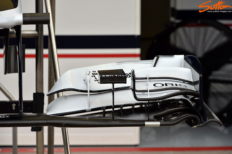

Williams FW35 - The newest of two Front Wings on show, this one features a standalone minor Cascade whilst the larger Cascade is split into 3 tiers

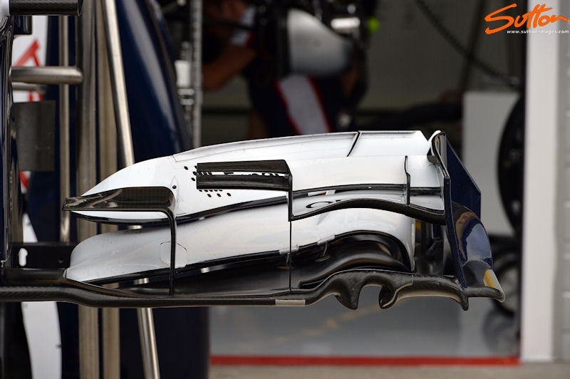

Williams FW35 - The other Front Wing on display is a descendant of the FW34 with the addition of a turning strake added within the main Cascade.

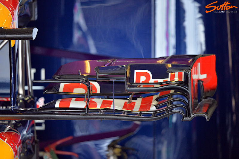

Red Bull RB9 - Front Wing detail

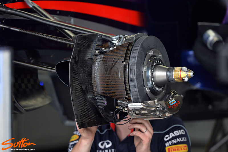

Red Bull RB9 - Front Brake assembly during build up

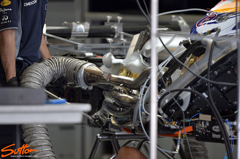

Red Bull RB9 - Exhaust detail during build up

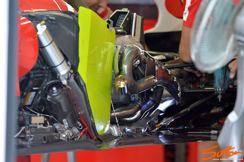

Ferrari F138 - Exhaust detail during build up (shows they once again use a Resonator chamber)

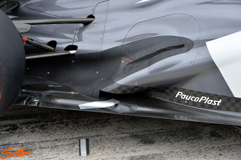

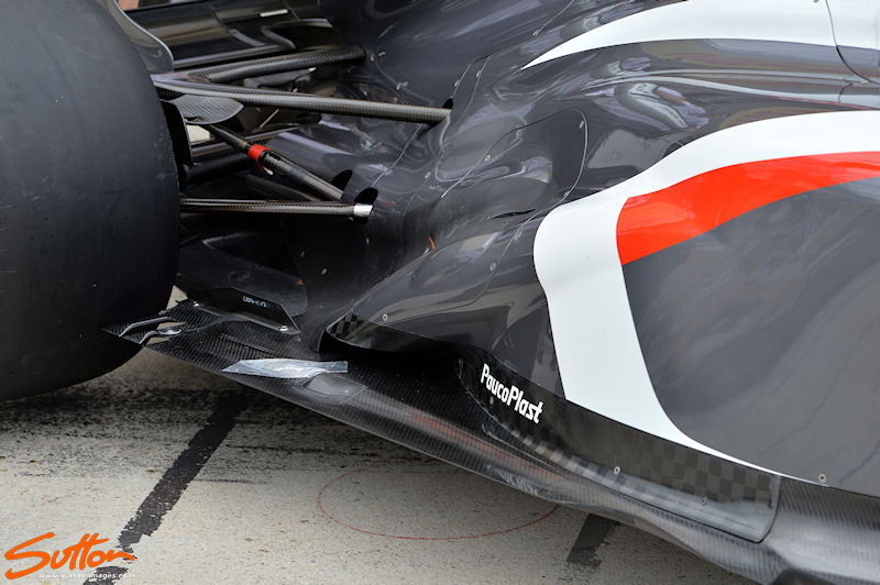

Sauber C32 - Exhaust and Cross Under Tunnel bodywork as tested at the Young Drivers Test, more images below

Lotus E21 - Front Wing Cascade detail
