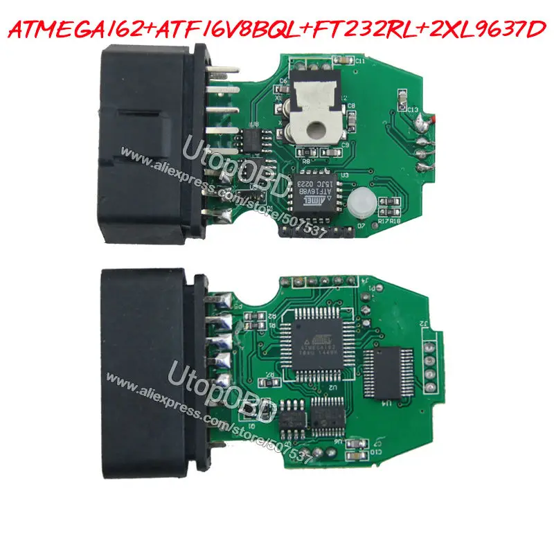

Може да го пребарате по:
VAG COM 17.1.3 VAGCOM 17.1 VCDS HEX CAN USB Interface FOR VW AUDI Skoda Seat VAG 17.1 Deutsch/English ATMEGA162+16V8+FT232RL
2017 VCDS VAG COM 17.1.3 VAGCOM VAG 17.1 HEX CAN USB Interface VAG17.1.3 FOR VW AUDI SKODA SEAT Support to 2017.02 German/English
Systems required: (32bit/64bit) of Windows 7, Windows 8, Windows XP, Windows 10 (but not all Win10 can work).  Not supported Windows on VM Systems (Parallels, Virtual Box, etc) ,MAC
Note:
*****All CD we have read and wrapped very well, if you got CD was broken or PC can not read, please don't open a dispute or give a negative feedback, you can message us to send link download.  ( Don't download from internet )
*****All cables we have tested before packing, but we can not guarantee it will work correctly with every buyer's Computer Systems and Cars.
Special Features:
1. No need disconnect internet, no need change date.
2. Sofware version: vag 17.1.3, can not update.
3.  Languages: German / English  (without other languages)
4. Not supported-- K2 protocol unit, USB 3.0. Must be USB 2.0 !
Firmware version: 1.96
It works with almost of VAG vehicles including VW / Audi / Seat and Skda from 1996 to 2017.02.
PCB (ATMEGA162+16V8+FT232RL):
Изберете кое има најмногу нарачки.
