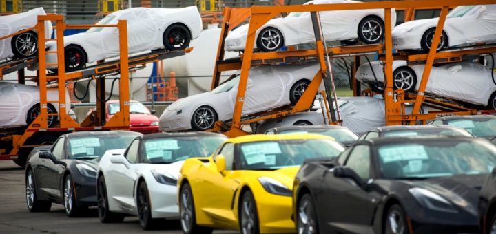

GM Confirms Six Month Waiting List For C7 Corvette
« Одговори #277 на: 04 Октомври 2013, 12:52:24 pm »
With the first run of 1,000 2014 C7 Corvette Stingrays making their way to select dealerships across the country, General Motors has confirmed to GTspirit that there is currently a six-month waiting list for the Corvette Stingray, making them late for the holidays.
Customers are paying premiums from $5,000 all the way up to $20,000 to be moved to the top of the waiting list, with demand even coming from Europe, Asia and the Middle East.
Only 900 out of the 3,000-plus Chevrolet dealerships in the U.S. are getting the opportunity to sell the new Corvette, after GM announced only dealers that had sold at least four Corvettes in 2012 would get the opportunity to sell the car.
